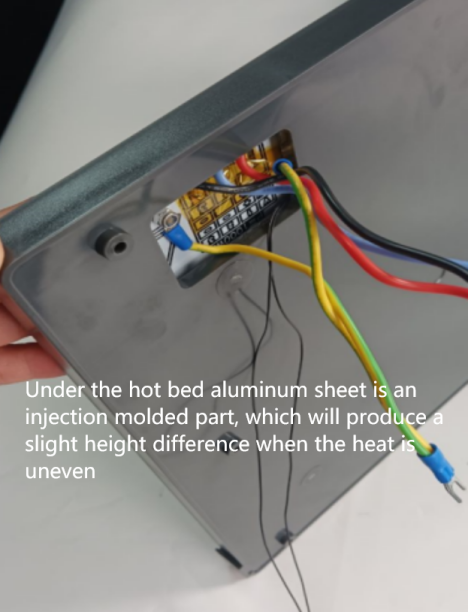

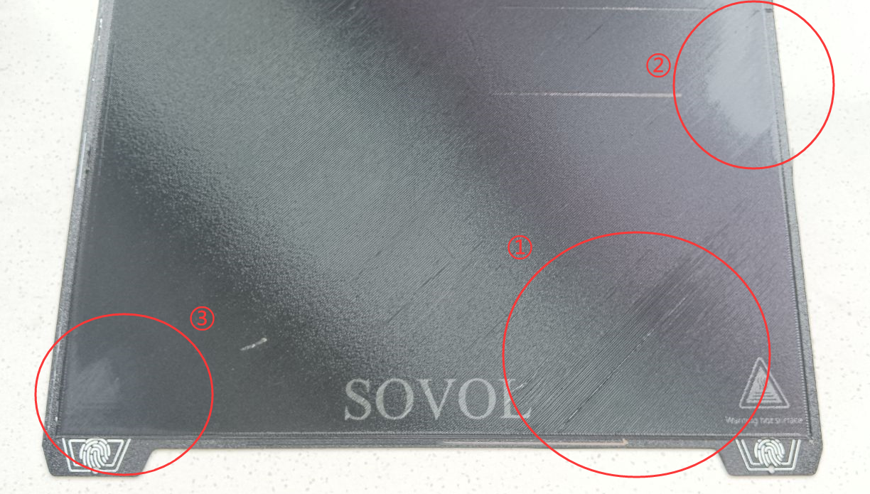

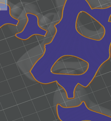

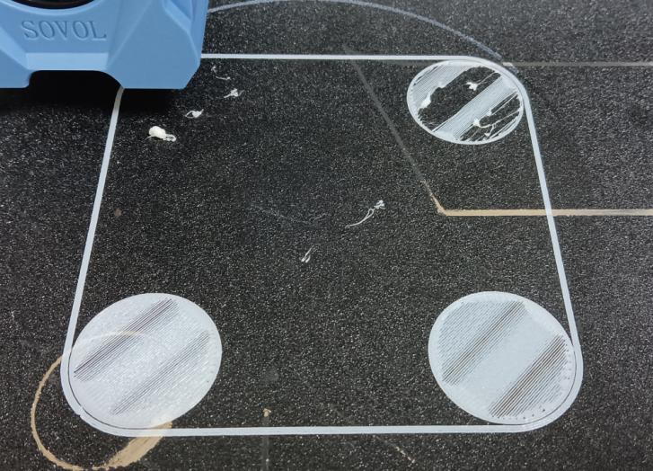

From the image, it is evident that during the initial printing of a large area, there are instances of filament non-adherence and over-extrusion. It can be attributed to the injection-molded parts at the base of the heated bed, which may undergo physical deformation during the heating process, lead to potential alterations in the distance between the nozzle and hot bed different from the 'Z calibrate' reference value. Figures 2 and 3 illustrate that this distance is lower than the specified value.

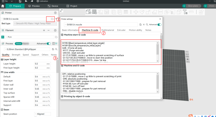

Situation 1: If you print the model more than 300 sizes, you find that your first layer of printing appeared to be over-extruded or scratched PEI plate, as shown in Figure.

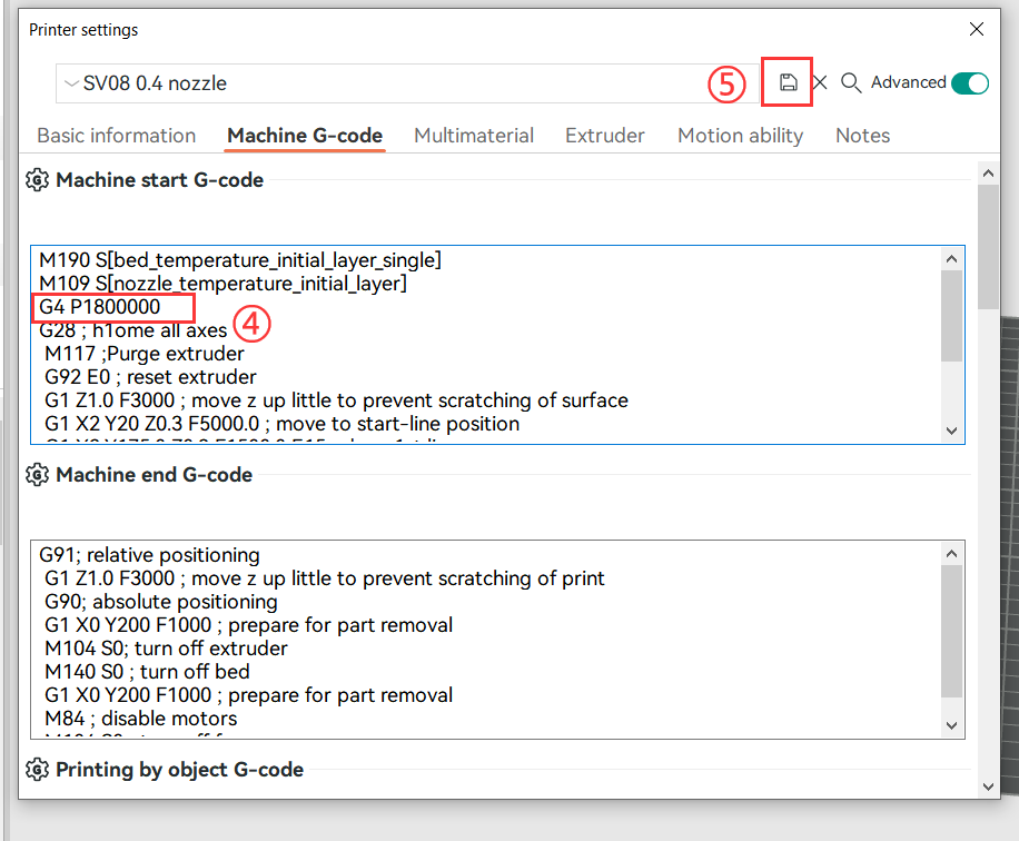

① Open the machine Settings page
② Click the printer Gcode setting interface
③ Find the starting Gcode location
④ Add “G4 P1800000” command before “ G28 ”command
⑤ Click to save Settings

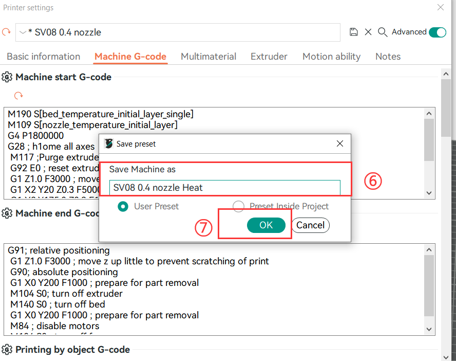

⑥ Set a name for easy differentiation
⑦ Click“OK” to complete the setup

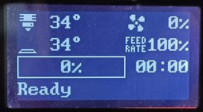

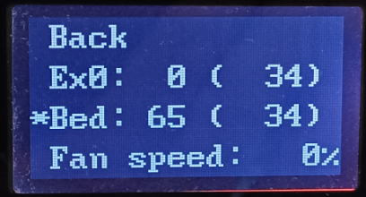

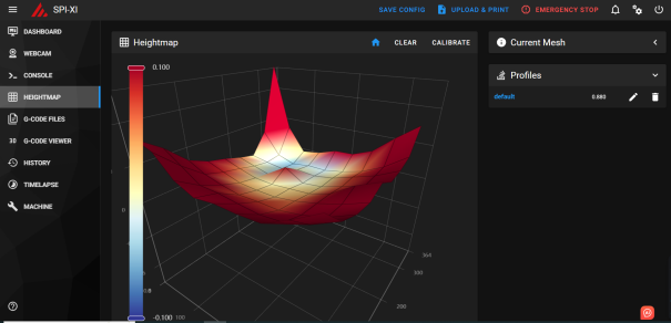

If you observe in the “HEIGHTMAP” interface of the mainsail system that the “Bed Mesh” data has a huge difference in the detection height of more than 1mm, you can also heat up the hot bed to 65℃ and keep it at 65℃ for 30 minutes to conduct bed mesh.
If you have followed the above method to detect after heating, but still get a detection picture with a huge difference in height, please feedback to Sovol support and provide the picture (use a ruler stuck on the hot bed plate, the gap between the ruler and the hot bed is more clearly observed, and it can easily pass through 4pcs of A4 paper).
