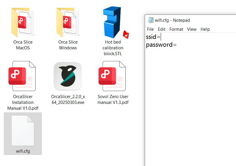

2. Please check the WIFI name and password in the WIFI.cfg file to make sure the account and password are correct. - Due to Linux restrictions, the network SSID name cannot have underscores (for example, network name can’t work, it must be "networkname")

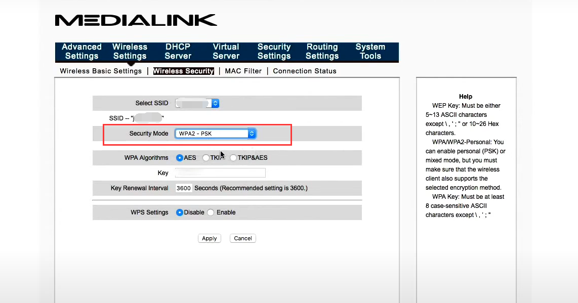

4. The security type in Linux network management can only be WPA2, not WPA3. Please change the security type in network management to WPA2.
(1) Log in to the router management interface
(2) Enter the wireless settings
Find Wireless Settings > Security Settings.
(3) Select WPA2 encryption
Select WPA2-Personal (home users) or WPA2-Enterprise (enterprise users) in Security Mode

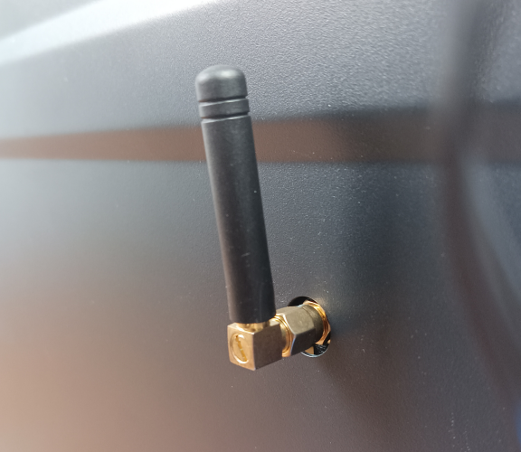

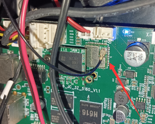

6. Check the connection of the WIFI antenna to ensure that the antenna is stable and not damaged. Remove the WIFI antenna and reinstall it.

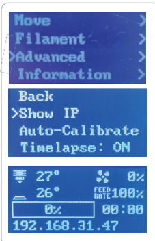

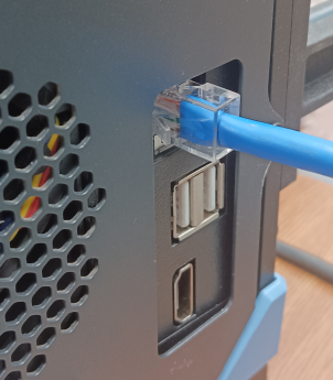

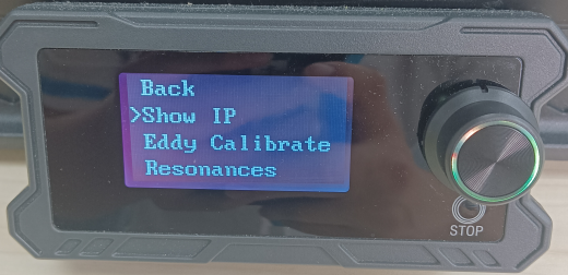

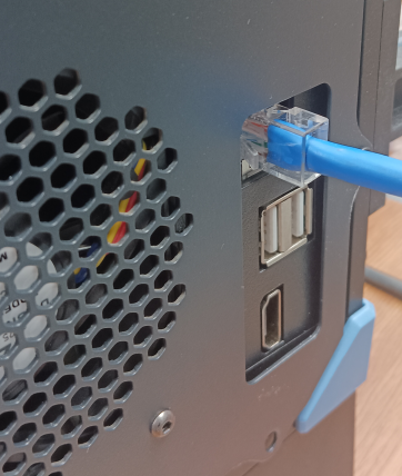

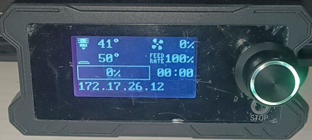

7. Use the LAN cable interface to connect to the network directly from your router network background, insert the network cable, click "Show IP" to obtain the IP address and enter the Mainsail interface
8.After successfully connecting the LAN cable, you can try to connect to the printer by SSH.

Step 1: Check the machine's WIFI antenna installation according to the figure below.
Check the security type of the router, it can only be WPA2, not WPA3. Check the working frequency of WIFI is 2.4GHZ.

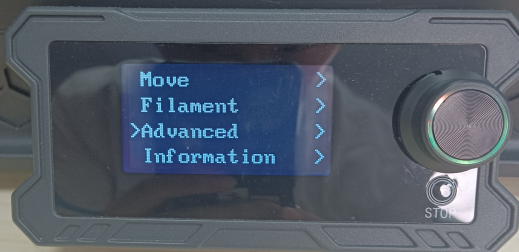

Step 3: Use a LAN cable to connect the machine to the router, click "Advanced" "Show IP" to get the IP address of the machine.

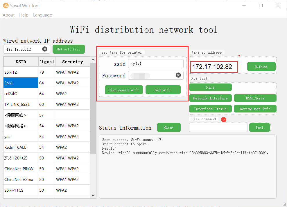

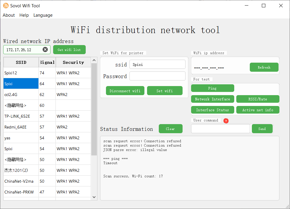

Step 4: Make sure the computer and the machine are connected to the same network (LAN cable can be used for connection), and then use the computer to install the appropriate network configuration software SOVOL WIFI Tool (Windows or Mac version). The steps for using the network configuration software are shown in the figure below.
Download:https://drive.google.com/drive/folders/1g3gMFGU5xVu-7DQ167__GEhxlufSJ6jZ
Step 5: Follow the instructions in the network configuration software, enter the IP address displayed on the machine, click Get WIFI List, enter the WIFI account and password, and click Connect.
Step 6: Use your phone as a WIFI hotspot next to the machine (you can try changing different locations to test the WIFI signal), and observe whether the mobile phone WIFI is found in the network configuration software. Then unplug the WIFI antenna on the motherboard and observe whether the mobile phone WIFI address is lost in the network configuration software. If you cannot connect, please report to SOVOL
Step 7: If the WIFI antenna connector on the motherboard is loose, please provide detailed video feedback to SOVOL
