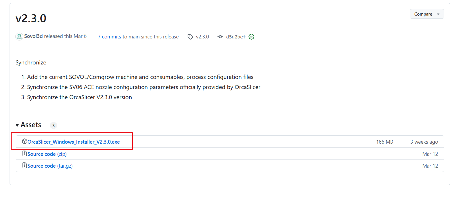

1、Find the download link of Orcaslicer in Github,Download the exe file that suits your current version on your PC.
Link:https://github.com/Sovol3d/Sovol-OrcaSlicer/releases/tag/v2.3.0

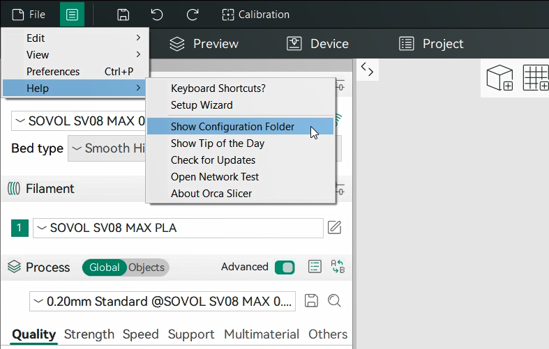

(1)Open Orcaslicer, click "Help" "Show Confiquration Folder" and delete all files in the OrcaSlicer folder under this path. (Note: the previously added machine configuration will also be deleted. Please export the configuration before deleting the folder. Please refer to step (3) to export your configuration file.)
(2)If you cannot open the configuration folder this way, please Open the location of the file under the installation path of Orcaslicer, find \Roaming\OrcaSlicer , and delete all files in the OrcaSlicer folder under this path.

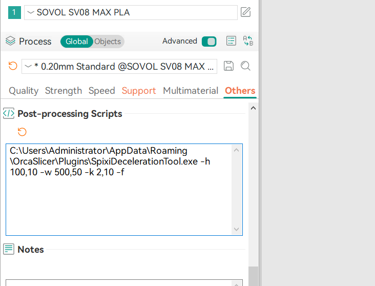

12、If Orcaslicer displays "The configured post-processing script does not exist: C:\Users\Administrator\AppData\Roaming\OrcaSlicer-sovol\Plugins\SpixiDecelerationTool.exe" when exporting Gcode after slicing, you need to use a plug-in to allow the printer to decelerate according to the increase in height and weight when printing higher models or heavier models.

Step 1: Click "Help", "Show Configuration Folder", create a new "Plugins" folder, and copy the plug-in to the folder.

Step 2: Then copy the absolute path of the plug-in into the location of the post-processing script, and add the "-h 100,10 -w 500,50 -k 2,10 -f" parameters at the end to use the plug-in normally.
/补充_(6).png)
Notes:
| -h: height | 100: height to start deceleration | 10: deceleration interval |
| -w: weight | 500: weight at which the speed reduction starts | 50: one gear is reduced every 50g |
| -k: speed reduction ratio | 2: ratio of each speed reduction | 10: minimum speed reduction value |
| -f is a file(no parameters, but must be added) | ||
