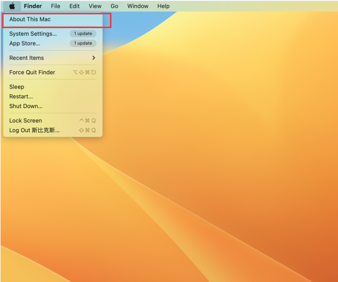

1.Click the Apple logo in the upper left corner, click "About This Mac" to check the processor type.
2.If it shows "Intel", it means it is an x86_64 system; if it shows "Apple M1", it means it is an ARM64 system.

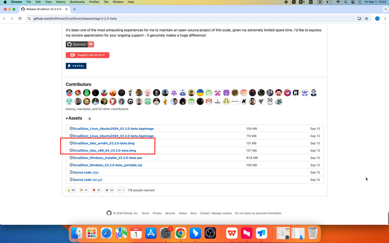

3.Find the download link of Orcaslicer in Github and download the dmg file that matches the computer system version
https://github.com/SoftFever/OrcaSlicer/releases/tag/v2.2.0-beta

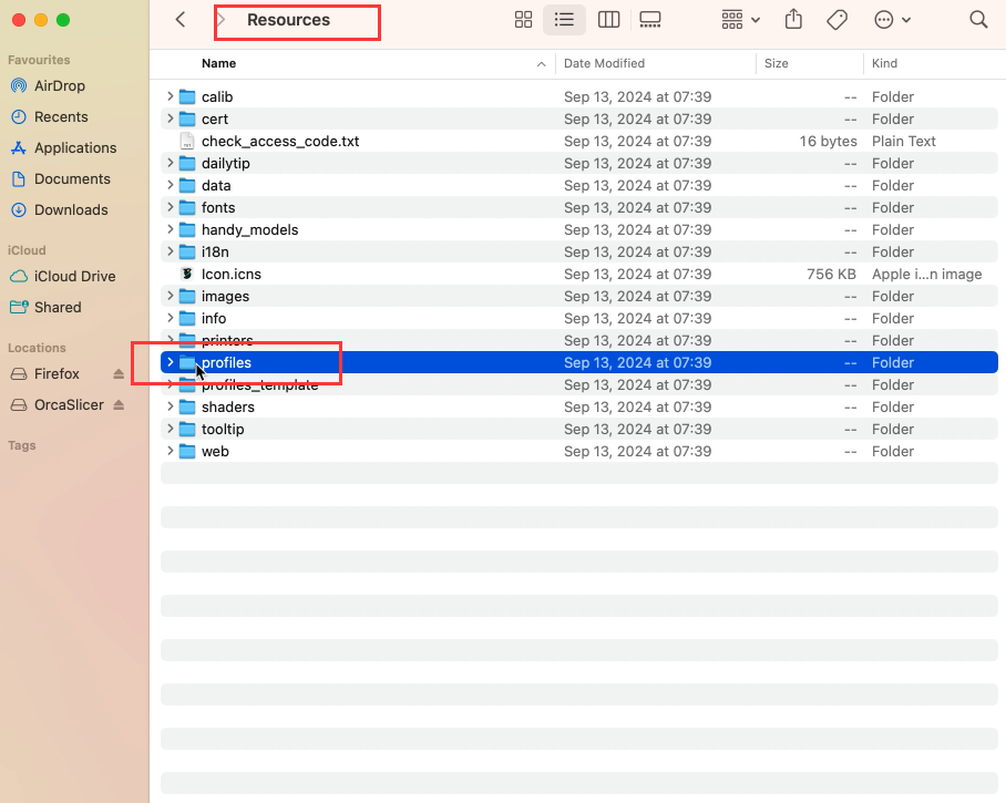

5.Find Orcaslicer in "Applications"and click "Show Package Contents"
6.Click "Contents", "Resources", "profiles"
7.Find and delete the existing "Sovol" folder and "Sovol.json"
8.Copy the contents in the materials to the "profiles" directory
